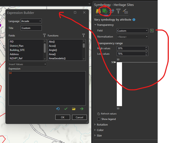

JohnWatt
If color and layer both have no transparency, check 'vary symbology by attribute' - eg below. Also check transparency set against any containing groups in the TOC, or a transparent layer sitting on top?
