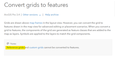

I think you need to convert the grid to features first.
https://pro.arcgis.com/en/pro-app/3.4/help/layouts/convert-grids-to-features.htm
clt_cabq
yeah, unfortunately this can't be done - once upon a time i thought it was possible to create a through a geoprocessing tool that told you what features fall within which grid cell but maybe I am misremembering that. This seems like it would be a pretty common need, seems useful for including in an appendix of a report or something, though in all honesty in all my years of doing GIS I have rarely used the reference grid capability. Appreciate the suggestion!
