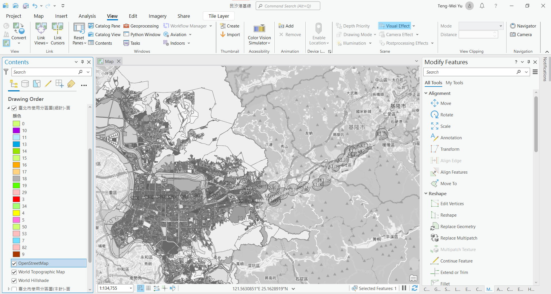

my map frame became whole monochrome after I saved the edits of features.
I don't think I've changed the color style or display settings.

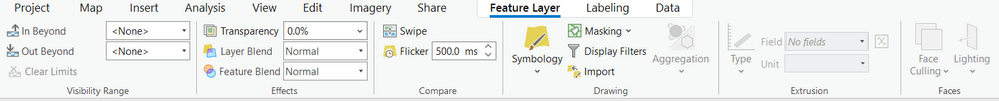

And I noticed the "visual effect" button cannot be canceled.
The "effects" under "feature layer" was keeping deafult.
Here's the screenshot:
Openstreetmap and the polygon feature which was set on symbology also became monochrome.

Hi Teng-Wei,
Thanks for posting this. That result is super-unexpected. The visual effects are only meant for 3D views (which is why that set of controls on the ribbon are disabled for your 2D view).
After some digging, I did find a way to get to that same state --> open a 3D scene view, enable the Black-and-White visual effect, and then convert the scene to a 2D map.  The visual effect option is brought over to the map and (like it was for you) it cannot be toggled off through the UI.
The property belongs to the map, so one (simple) way to get back to a 'color map' is to add a new map to your project, and then copy-paste your layers over to the new map. A bit draconian, but it'll work.

WilliamYu811
Hi Nathan,
Thanks for your solution,
after inserted a new map and pasted all layer to the new one,
the problem had been solved,
I'm very appriciate about that.
