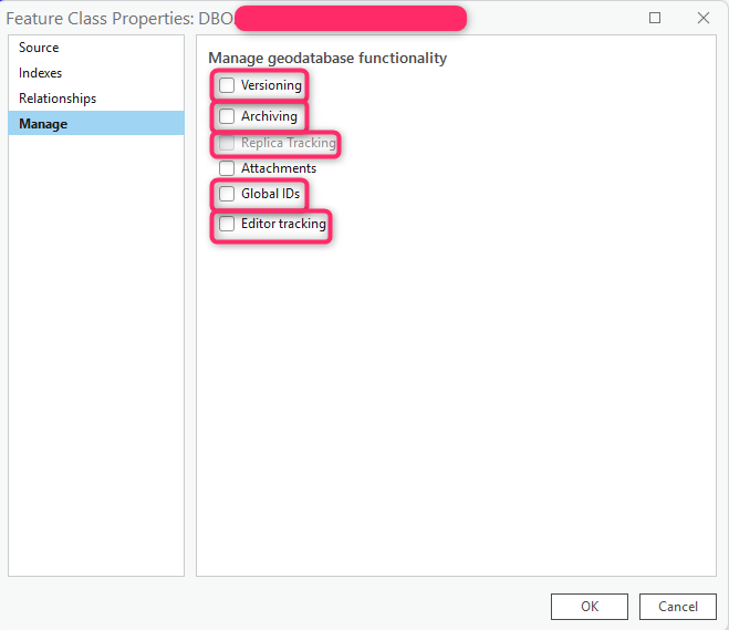

Hi! I am publishing layers for collaboration from ArcGIS Pro to Portal using a SQL Server .sde connection. I understand that each feature class needs Archiving, Global IDs, Editor Tracking and Replica Tracking enabled to allow sync. I can enable these options under the Manage geodatabase functionality pop-up for Feature Class Properties, but why do the options revert to being disabled after a few minutes?
I have attached a screenshot of the properties I am referring to. I understand Replica Tracking is currently greyed out, it becomes available after enabling Archiving.
Any assistance is appreciated!managegdbfunctionality.pngmanagegdbfunctionality.png

Are you connected as the data owner for that feature class?
It looks like the data is owned by DBO. That user would need to enable that functionality.
https://pro.arcgis.com/en/pro-app/latest/tool-reference/data-management/register-as-versioned.htm
