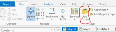

That is what I did, but I had to add the layers after. Is there an 'Add Data' tool? I haven't seen one. Thank you!
JayantaPoddar
MVP Alum
Not a GP tool, but the one in the ribbon (Add Manually).
Think Location
RandyMcGregor3
Got it. Thank you very much.
