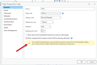

I have not tried this by clobbering existing layers with the MakeFeatureLayer tool, but have used other tools/code to overwrite feature layers within my Pro project that I publish/overwrite existing services.
In my case, I check the Map layer properties to Allow assignment of unique numeric IDs for sharing web layers:
And, in the Geoprocessing options, Allow geoprocessing tools to overwrite exiting datasets, and un-check "Remove layers that reference data overwritten by geoprocessing tools":
This way, the layers are not removed, updated, then re-added, they are updated in place and the ID assignments do not change.  I can then overwrite my feature service with the new data while maintaining item ID's.
