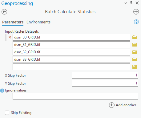

I have just started to use 'ArcGIS Pro 3.2.2' (before I used 'ArcGIS Pro 3.1') and I'm working with the tool 'Batch Calculate Statistics':
I have used this tool with 4 geotif files:
marcozanieri_1-1714210351716.pngmarcozanieri_1-1714210351716.png3880
With the following settings:
Here below all the details and the time that the application needs to complete this task:
