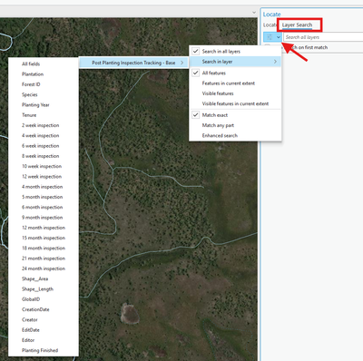

Also, I assume you are currently using the Locate function like this?
From what I can see, there is no way of changing this to the default setting unfortunately.
