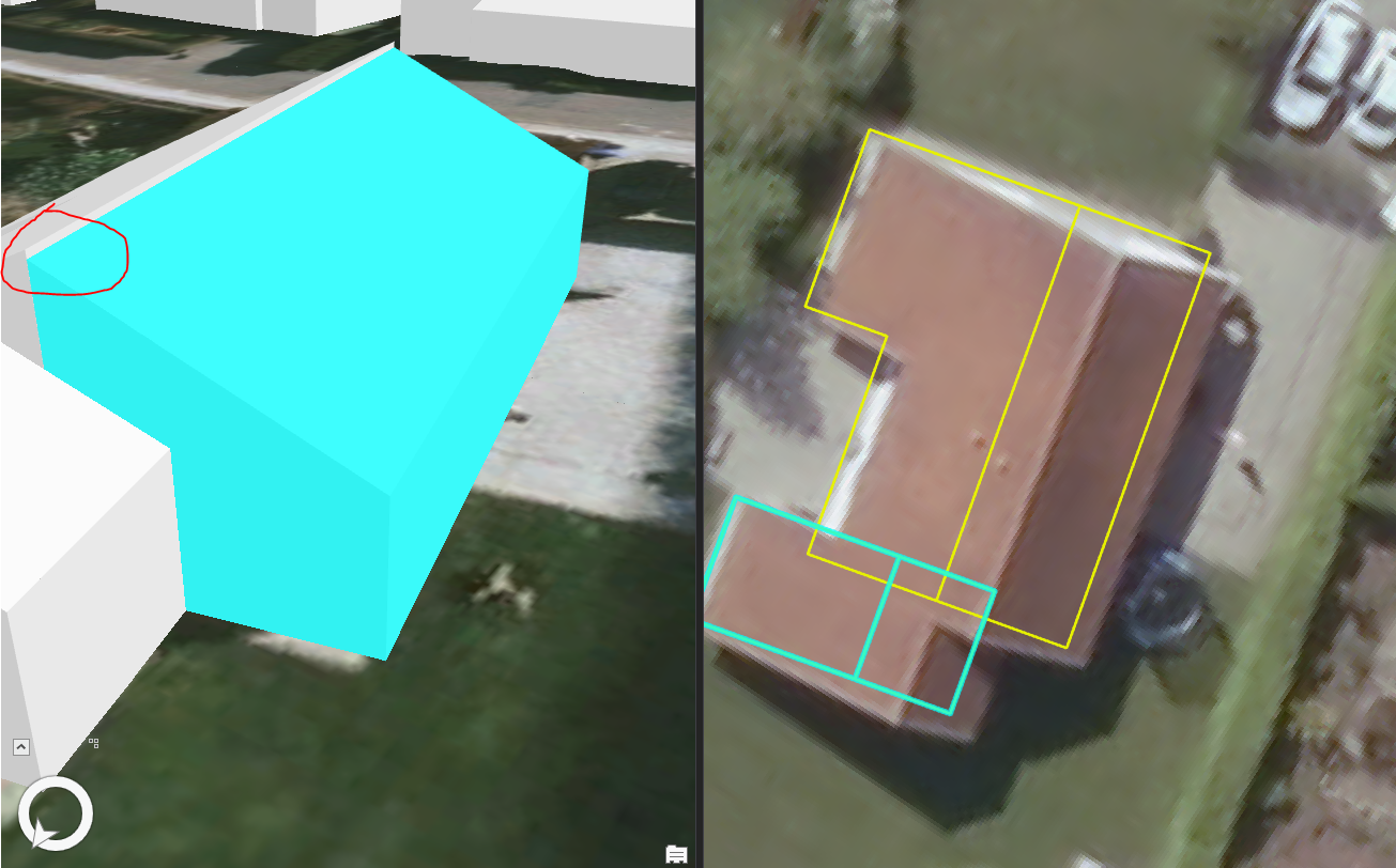

I'm trying to make a building like this, but somehow my different roofforms don't line up, the way they should.  See below.  I've split the building footprint into two different Shed roofform with the same Building height attribute. Both have the same Base elevation and the same Building height - the only parameter that is different is the elevation height for the lower part of the roof.
Any ideas?  Even though it would work as it is now in the grand scheme of the overall city model, but it still bugs me, when I am going through each house manually, that it can't be as perfect as I would like it to be.
