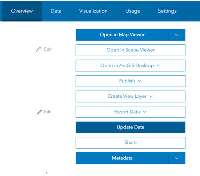

Depending on your needs, you might be able to use the Update data function to add data to your hosted feature layer.
This blog by Bekah will walk through what Update Data is and when to use it.
