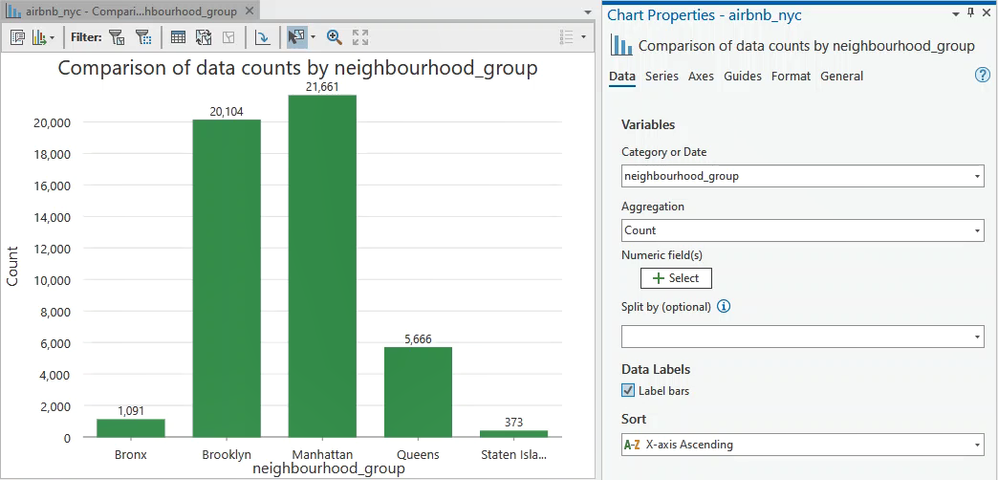

I wanted to add that charts are another effective way of exploring your data in ArcGIS Pro. Bar charts can help you quickly visualize the frequency distributions for categorical fields without needing to create an extra output table.
Here I’ve created a bar chart that shows the counts for AirBNB listings by the “neighbourhood_group” field:
You can even group the data by an additional categorical field by selecting the field in the Split by dropdown. Here I’ve split the chart above by the “room_type” field, and now it displays the breakdown of AirBNB listings by “neighbourhood_group” and “room_type”:
