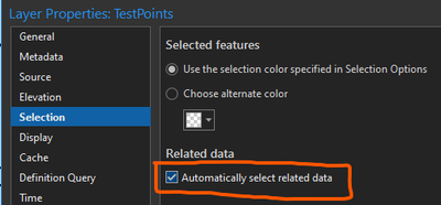

I have 2 tables that are related through a relationship class. I am trying to make the ID field in one table clickable so that when the user clicks on this field, it should open the corresponding record in the other table. Can this be done in ArcGIS PRO?

Option 2: Automatically select all related features
You can make it so that when you select a feature, all related features get automatically selected. This options can be found in 2 places:
The layer options:
The Attribute Table:
