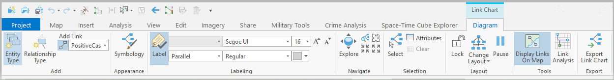

In case you hadn't see it yet, here is the Link Chart Ribbon
