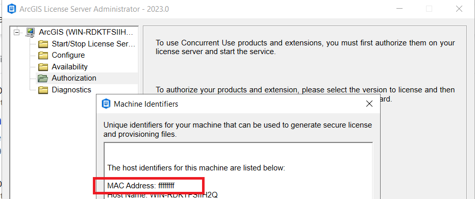

I'm trying to authorize licenses downloaded from my ESRI using LSAdmin.   I keep getting a message that the MAC address in the license file does not match the MAC address of the machine.  When I click on "Machine IDs" I get the message below saying the MAC address is "ffffffff".    When I issue ipconfig /all my Ethernet Adapter Physical Address is "00-00-00-06..blablah" -- a regular MAC address.   Not sure why LSAdmin is not picking this up.
If anyone has run into this and found a solution, any suggestions would be much appreciated.
Thx,
E

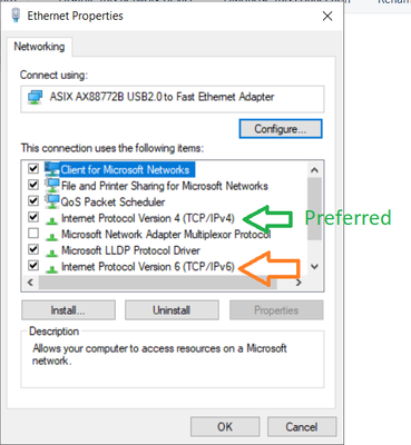

EdwardBlair
Hi Richard (or anyone) -
I followed you suggestion and made IPv4 preferred over IPv6 - as indicated in the screenshot below (I think).  The darn license manager still returns a MAC address of "ffffffff".   And when I try to authorize my license file I still get an error that the MAC address in the license does not match the address of the machine.
Any other thoughts would be greatly appreciated.
Ed
