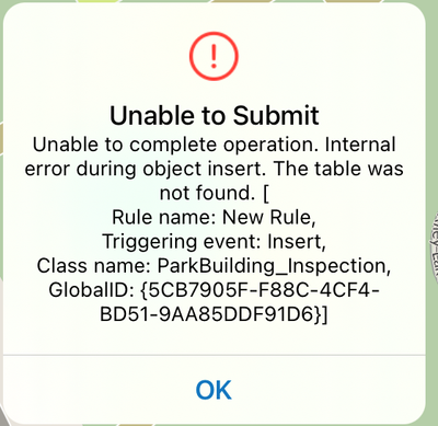

ZachBodenner
MVP Regular Contributor
That is an amazingly thorough answer, thank you so much for the time you spent on it! I copy/paste/adjusted to fit my use case, and the expression verifies, the console message demonstrated the filter is working, and I published the service out to give it a test.
// Calculation Attribute Rule on Inspections
// field: leave empty
// Triggers: Insert
// Exclude from application evaluation!
// get the related asset
var asset_id = $feature.GUID
var assets = FeatureSetByName($datastore, "epgdb.PARKS.ParkBuildings")
var asset = First(Filter(assets, "GlobalID = @asset_id"))
console (asset)
// if there is no related asset, abort
if(asset == null) { return }
// else push an edit to that asset
return {
    edit: [{
        className: "Park Buildings",
        updates: [{
            objectID: asset.OBJECTID,
            attributes: {
                Status: $feature.Struct
When I attempt to add a record in the web map (via field maps) I get the error:
So it looks like maybe it's a problem with the class name? The rule verified no matter what text I had entered there, so I figured it wasn't important, but I must be wrong. I guessed the best thing would be to use the parent feature class as the className? Any specifics that I missed?
Happy mapping,
- Zach
ZachBodenner
Another update, I monkied with it a little:
// Calculation Attribute Rule on Inspections table
// Triggers: Insert
var assets = FeatureSetByName($datastore, "epgdb.PARKS.ParkBuildings",['GlobalID','Status'])
console (asset)
// if there is no related asset, end expression
return {
    edit: [{
        className: assets,
        updates: [{
                attributes: {
And now the error reads "Invalid Function arguments" I don't know if that means I'm closer or farther away from a correctly written expression, but I think I at least got the class name correct?
Happy mapping,
- Zach
ZachBodenner
I wanted to share one more update in case anyone else is following this thread: I got my code to work! I see after review that I had misplaced some of the code elements which probably caused some problems. I replaced the GlobalID parameter for the updates function, but still had some problems. I tried using quotes around all the keywords and parameters after the last return as per ESRIs documentation, but that didn't make a difference either. From what I can tell, once I replaced my missing code bit as the ObjectID (and not the GlobalID), that's when it clicked. The last weird thing is that I actually do need to check both insert and update in order to get this to run. Just having insert checked leads to the rule verifying but not running when a new record is created, which is kind of strange, but ultimately not too bad.
// else populate attribute with the edit
return {
    edit: [{
        className: "epgdb.PARKS.ParkBuildings",
        updates: [{
            attributes: {
                Status: $feature.Struct,
                LastInspDate: $feature.InspDate
Happy mapping,
- Zach
