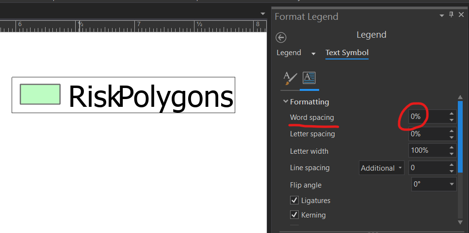

1.) Legend text issue.
Creating a legend for a map layout. When I have created it, all the spaces between words disappear. Adding aditional spaces acts like insert mixed with delete, moving the words on top of each other. This does not occur on all 4 map layouts in the project, only the ones with contours and DEM's even if they are not in the legend
(1st image is the correct formating on the right, v.s. the legend output, 2nd image is the diffrence when 4 extra spaces are added.)

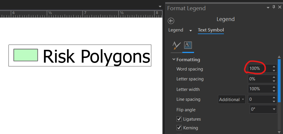

Hi Bryn,
Issue #1:
This is likely an issue with the font you are using in the legend and not an issue with the legend itself.  In particular, the Word spacing for the Text symbol could be at 0%.  Here is an example:
If Word spacing is 0& change the value to 100%. This should fix your issue.

BrynTownend
Thanks for that fix Tom. I'll follow up with ESRI support at some point for issue 2.
