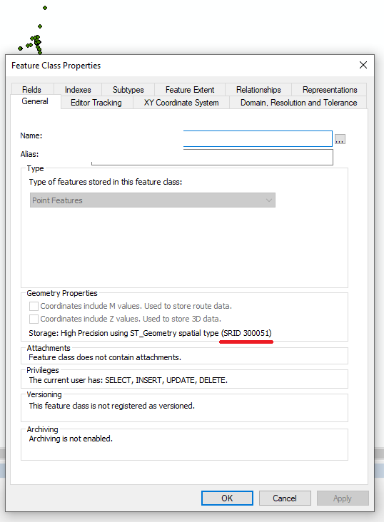

That SRID 300051 comes from ArcMap. I'm not sure what the reasoning is behind it:

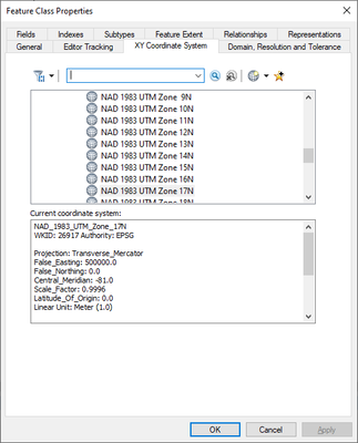

Definitely wondering what's going on here. What does the XY Coordinate tab say?
Bud
Legendary Contributor
Thanks. That helps.

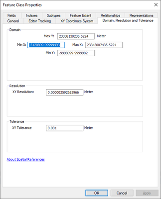

Here's the XY Coordinate System tab of the original FC:
And here's the Domain, Resolution and Tolerance tab:

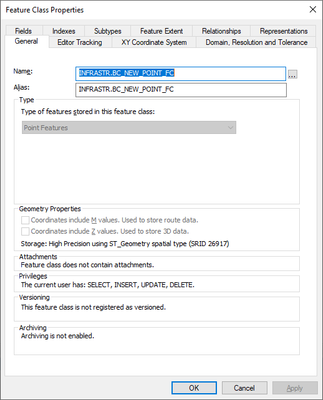

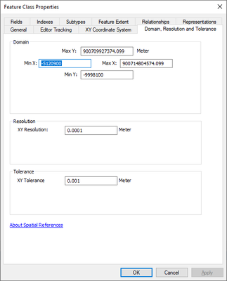

I did a test just now where I created a new FC from scratch using Catalog (using all the default settings).
The SRID is 26917. So that seems more normal, yes?
Maybe there was just something something funky going on with my original FC.
