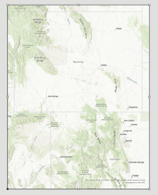

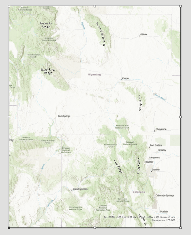

8.5"x11" map showing Wyoming in the top half.
I want to resize the map to show only Wyoming.

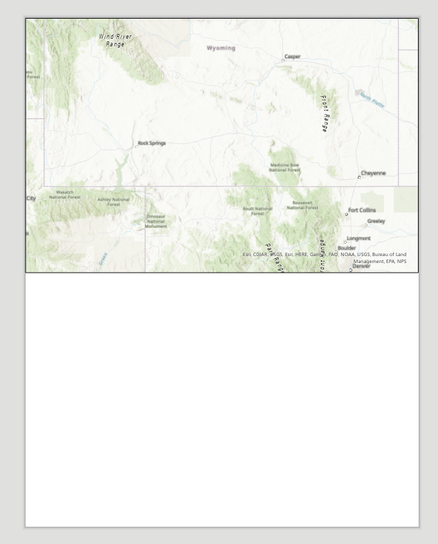

The same map, resized by dragging from the bottom up to 8.5"x5.5". The center of the map has been retained, pushing the southern border of Yyoming into the center of the map and pushing the northern border out of frame.

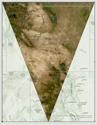

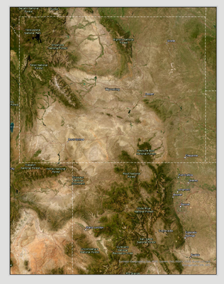

So, I took another look at this today and found a workaround. It isn't perfect, but I think it should work provided you're willing to tinker for a bit. Basically, Aubri was right, I just didn't want the map frames to have to be the same size.
  1. Make Map #1
  2. Make Map #2

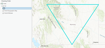

  3. In Map #2, add a polygon and draw the extent you want.AlfredBaldenweck_0-1707839450840.png

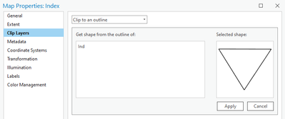

  4. Open Map #2's properties and Clip to Feature Outline for the polygon
  6. Open Layout, insert Map Frame for Map #1.
  7. Insert a Map Frame for Map #2, the exact size and placement as the first map frame.
  8. On the Elements Pane (Why don't we call it the Properties Pane?) constrain Map Frame #1 to match center and scale with Map Frame #2
  9. Profit
Just remember to reset the clipping every time you edit the polygon(s).
Also, you can pair this with multiple maps and/or definition queries to get multiple frames this way.
I don't think it'd work really well for page queries, though.

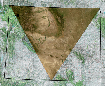

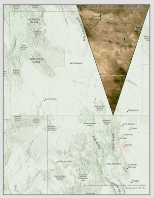

A simplified use case to use as an example is I have a rectangular map frame whose vertices I want to change.
1) Map frame whose vertices I want to edit. There is another map frame with the exact same extent used as reference for this exercise.2) I can edit the vertices just fine so long as the total frame size stays the same
3) If I change the total height or width, the entire thing moves.
Casper is now in the approximate location of Lusk, and the Bighorn Mountains are covering the Bearlodge Mountains
3.5) I've changed the map frame's height now, and apparently the state line actually halfway up the state.
I'd like to pick an extent, pin in place, then change the map frame around it without having all of its contents move around. The Map constraints I already discussed don't work in this case, but neither would the constraints for linked map frames for the same reasons. Bookmarks also don't work, since they function the same as Maintain Extent or zooming to an index layer. I can of course just readjust, but as I previously mentioned, that's time consuming and rather annoying. The whole "Maintain center when resizing" is frequently useful behaviour, but I'd love to be able to turn it off.

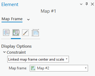

  1. Make Map #1
  2. Make Map #2
  9. Profit
