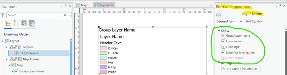

I did a quick test on 2.6  using a file geodabase feature class of US States. The layer uses a unique value renderer and is part of a group layer. As you can see from the screenshot below all text elements of this legend item are checked on.
The export result matches what I see in the layout.  Now lets turn off all the text except for the labels.
When I export I get what I see in the layout. With the current information I have I am unable to repro the problem you are reporting.
There could be something specific with your data that is causing the problem. Can you contact Esri Support? They are better equipped to handle troubleshooting steps and gather bug data. They can be contacted at https://support.esri.com/en/contact-tech-support.

Hi nmarieh,

nmarieh
Hi Tom!
Thanks for the help! I think I've got it working now—I didn't realize you had to have certain layers already activated in order to check and uncheck those boxes.
