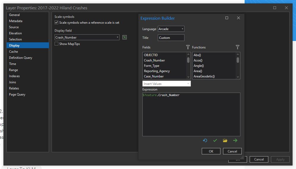

I was able to have some success at changing the labels of my exported KMZ by using the expression builder under the "Display" tab in the layer properties. I don't think this is a full solution but it is what I needed in order for the ToC in GE to show the attributes I needed! KMZ_display.jpg
