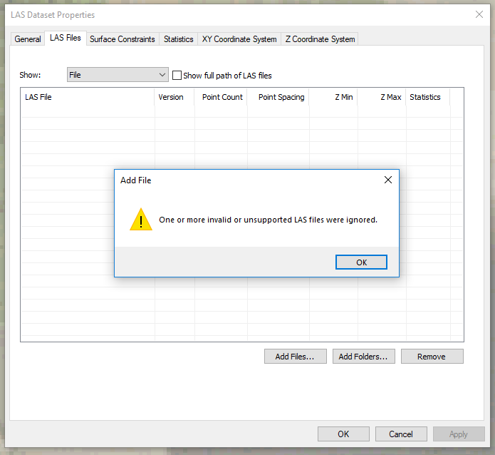

For some reason, I am unable to load LAS files unto my LAS dataset. Adding files through the LAS Dataset Properties gives me this error:

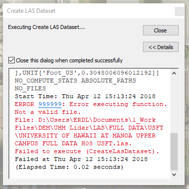

Going through the Create LAS Dataset route gives me this:
