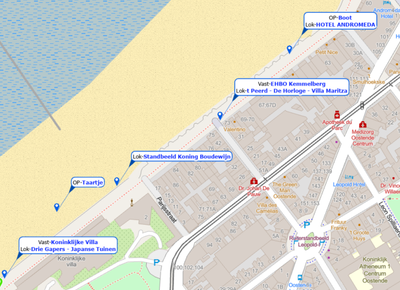

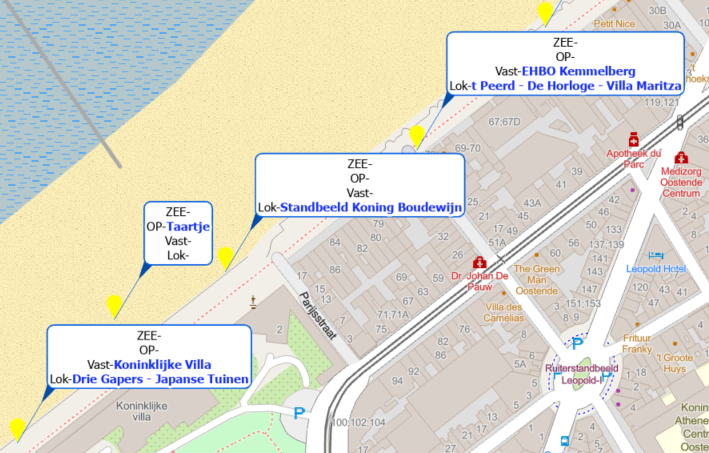

I have 4 Attributes  in One label.
I have 4 attributes in 1 label.
Each attribute starts with a title and then the text.
If the text = null for an attribute I would not want to see a title for this attribute.
Do I have to write a completely new script for each attribute?
"ZEE-"&"<BOL><CLR red='21' green='47' blue='255'>" & [Km_paal_in_zee] &  "</CLR></BOL>"& vbNewLine &
" OP-"&"<BOL><CLR red='21' green='47' blue='255'>"& [Oriëntatiepaal]&  "</CLR></BOL>"& vbNewLine &
"Vast-"&"<BOL><CLR red='21' green='47' blue='255'>" &[vaste_plaatsnaam]&  "</CLR></BOL>"& vbNewLine &
"Lok-"&"<BOL><CLR red='21' green='47' blue='255'>" &[Lokale_benaming]&  "</CLR></BOL>"

Switch tha language to Arcade, use this expression:
var titles = ["ZEE", "OP", "Vast", "Lok"]
var values = [
    $feature.Km_paal_in_zee,
    $feature.Oriëntatiepaal,
    $feature.vaste_plaatsnaam,
    $feature.Lokale_benaming,
var lines = []
for(var i in titles) {
    if(!IsEmpty(values[i])) {
        var line = `${titles[i]}-<BOL><CLR red="21" green="47" blue="255">${values[i]}</CLR></BOL>`
        Push(lines, line)
return Concatenate(lines, TextFormatting.NewLine)
Have a great day!
Johannes

NicolasSoenens
You made my day!
Thanks
