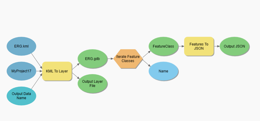

I need to make a GP service that takes a KML file, and will return a JSON containing all of its featureClasses.
Currently my problem is that I don't know how to return a JSON with all of the feature Classes in it(it only writes the JSON of the first Feature Class).
this is the model:
thanks 🙂
BarryNorthey
Try using in-line variable substitution to uniquely prefix the output file names and prevent overwriting.
%Name%_FeaturesToJSON.json
