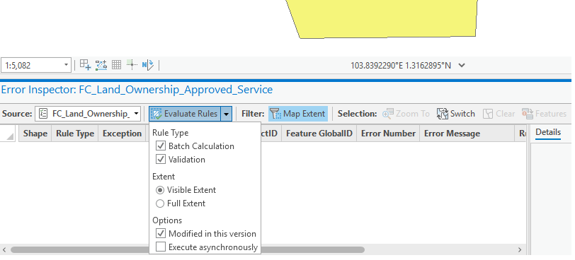

Hi All,
We are using ArcGIS Pro Version 2.9.
In this we created branch version of the feature class and doing editing on the branch version of the feature class. We implemented some validation rules and for validation using error inspector, in evaluate rules we checked "Modified in this version" but when clicked on evaluate rules button, its evaluating all the features ( including non edited features in this child version) existing in the feature class.
Scenario:
In this feature class there are 100 features and we have added one new feature in this branch version.
When we run "Evaluate Rules", it is evaluating all the 101 features, ideally should evaluate only 1 feature which we added newly.
Expected behavior:
When we run "Evaluate Rules", it should run validations on the newly created feature.
any suggestion or alternative to achieve this. Thanks

HusseinNasser2
Your expectation is correct. Evaluate with changes - in version option should only evaluate features updated/inserted in the version.
We were able to reproduce locally and this seems to be a bug in Pro where if you close or minimize the error inspector the options won't persist while the UI continue to show you that it did.  We will try to address this in the next 2.9 patch.
As a workaround
1) Switch to your version
2) Remove the error layers
3) Close the error inspector
3) Save and close pro
4) Open the project back, Add error layer, then open the error inspector make sure the error inspector is on docked (not auto-hide)
5) Select the modify in version option and evaluate, should work.
