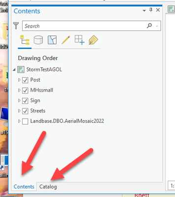

Not sure about keyboard shortcut, but you shouldn't need to close one to work with the other.
You can dock them on top of each other, then just pick from the tab at the bottom:
Or you can dock/float each on individually in different locations.  I normally run with Contents pane on the left,then Catalog and all other panes stacked on the right.
