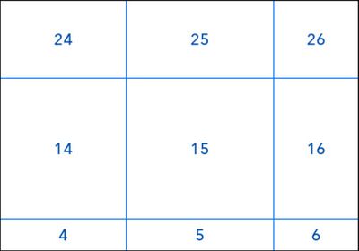

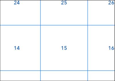

I am creating a Map of a city area and I am trying to figure out how to keep the section lines in the middle of the section.  If a section is only slightly within the map it automatically shoves the section number to the edge. Someone suggested to Annotate the Label but the only seems to work like 1 out of 20 times.   Any thought? Thanks!!

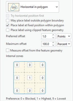

JesseWickizer
To keep polygon labels placed in the center of the feature, check on the Place label at fixed position within polygon option. By default this places the labels at the center of the polygons that are clipped by the map frame.
Then un-check the Place label using clipped feature geometry option so that the label stays at the center of the full polygon feature, not the feature clipped by the map frame.
