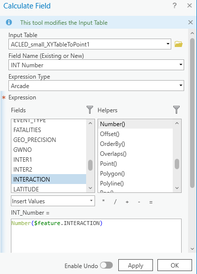

Your GAS, OIL_COAL_COKE, and OTHER_NO fields are text and not numbers. Looking at your screenshot they are all left justified, while numeric fields are right justified. Graduated colors will only work with numeric values.
You will need to add 3 additional number fields to your data. Then calculate the field (right-click on the field header and select calculate field) using Arcade to transform the appropriate value to a number. Do this for each of your three fields. You will then be able to use the graduated colors symbology on these new fields.

I am having the same issue as OP. I was wondering what would the expression look like if we were to add multiple fields into one new numeric field. For example, I need to add the text fields UTIL_GAS and TANK_LP_GAS into the new numeric field "GAS," but every time I try to add them the way you showed previously, it says there is an error. Thanks!
AnnaSloan
Nevermind. I just tried adding a "+" in between them and that worked. For anyone else wondering it would look like this - "Number($feature.UTIL_GAS+$feature.TANK_LP_GAS)"
