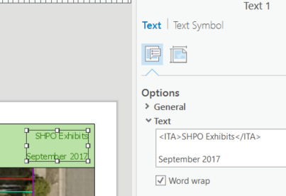

This seems like an easy and dumb question but I cannot figure it out... I want text on my layout to be italicized.
I found on this site that the XML tags from ArcMap still persist to ArcGIS Pro:
Text formatting tags—ArcGIS Pro | ArcGIS Desktop
So, I went and tried this but my text does not show up as italicized:
Is there an easy and dumb answer to this? I'm using ArcGIS Pro 2.0.1

Ok, I might have figured this out. The default text font in ArcGIS Pro layouts is Tahoma. It appears that by default, Tahoma does NOT have an option for italics whatsoever.
I find this very odd. If I were to switch to something like Verdana, I get more options, like this:
I wonder whose idea it was to pick #tahoma as a default font.... Weird.
