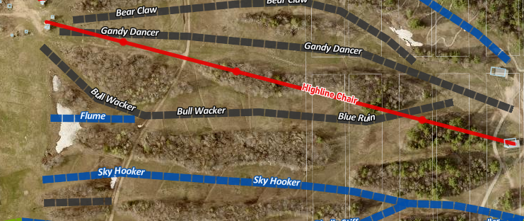

When I set up a line layer to have marker symbols at its end nodes, it looks great as a feature layer. But when I create a vector tile package from it, the tile packaging seems to ignore the marker placement parameters and simply distributes markers along the line instead.

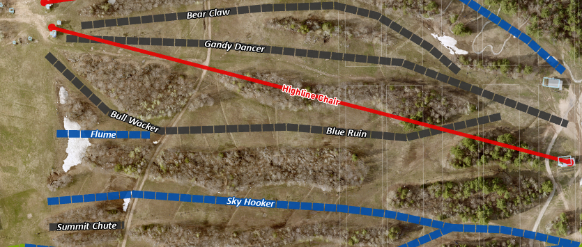

The feature layer symbology correctly displays the (red) line with markers only at its ends.
Vector tile renders the (red) line with points distributed along it:

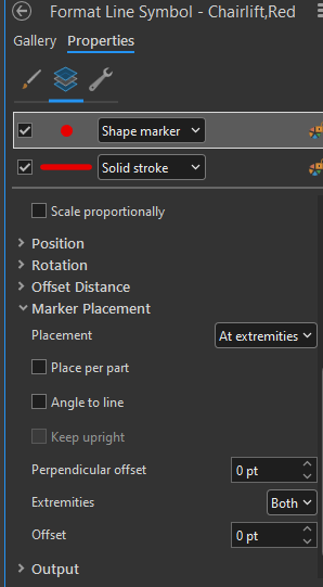

Here is how the feature layer is symbolized in ArcGIS Pro:

DanPatterson
MVP Esteemed Contributor
from
Create Vector Tile Package (Data Management)—ArcGIS Pro | Documentation
2nd bullet
Some symbology cannot be resolved in the tile creation process. Avoid symbolizing layers with hatched or gradient fills, markers along lines or polygon outlines, or most symbol effects. ...
So perhaps it is a know limitation, but contacting Tech Support might provide confirmation
