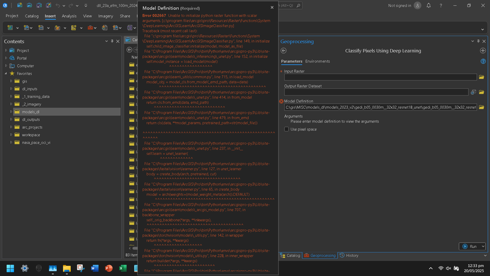

By the way, I was able to execute the deep learning model training in an ArcGIS Pro v. 3.4 instance I have on a different machine. However, when I move said model to the machine with ArcGIS Pro v. 3.5, I get an error. I also even get an error with an older deep learning model that worked under v.3.4 (screenshot below). Something tells me that the issue is with the deep learning package for version 3.5, but I am open to suggestions.
