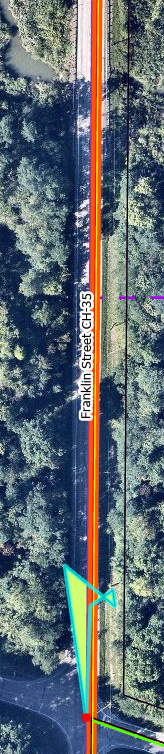

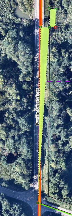

I'm trying to draw easements using the traverse tool. The top picture is what it's supposed to look like. The bottom picture is what it does when I click finish. This is in Pro 3.4.0, and I've tried clearing the cache and restarting Pro, but the problem persists.

Hi Thomas. Are you clicking the Finish button in the Traverse tool's pane or the one (with the green check mark) on the Edit toolbar? Do we see a difference in behavior when using one button versus the other?
ThomasGoodridge
The editor checkmark worked, but the traverse button doesn't. Weird.

Hi @ThomasGoodridge, thanks for letting me know. I see the behavior on my side as well. The following defect has been logged for this behavior.
BUG-000176312: When creating a polygon feature using the COGO Traverse tool, the Finish button in the tool's pane finishes the drawing differently than the Finish button on the Edit toolbar
JakeAdamsUGRC
For what it's worth, I'm seeing the same behavior in Pro 3.3.0
