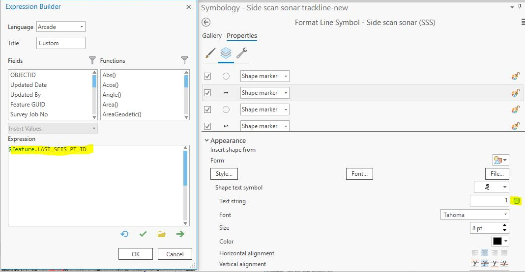

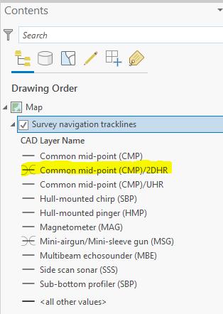

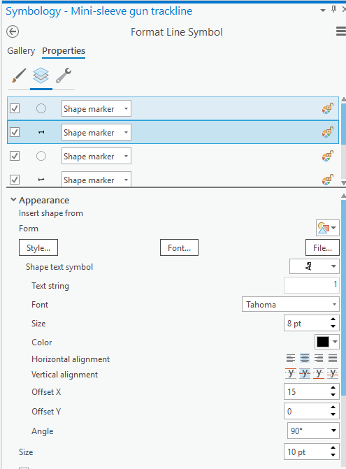

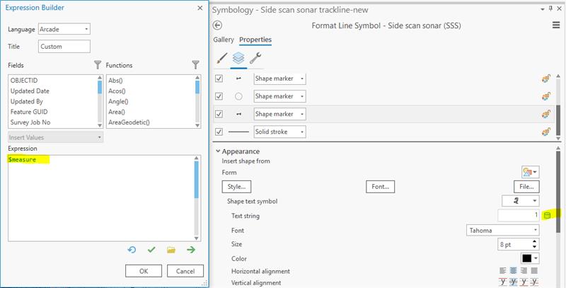

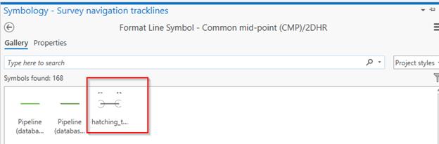

This is our hatching symbology we have defined ourselves and saved to *.stylx

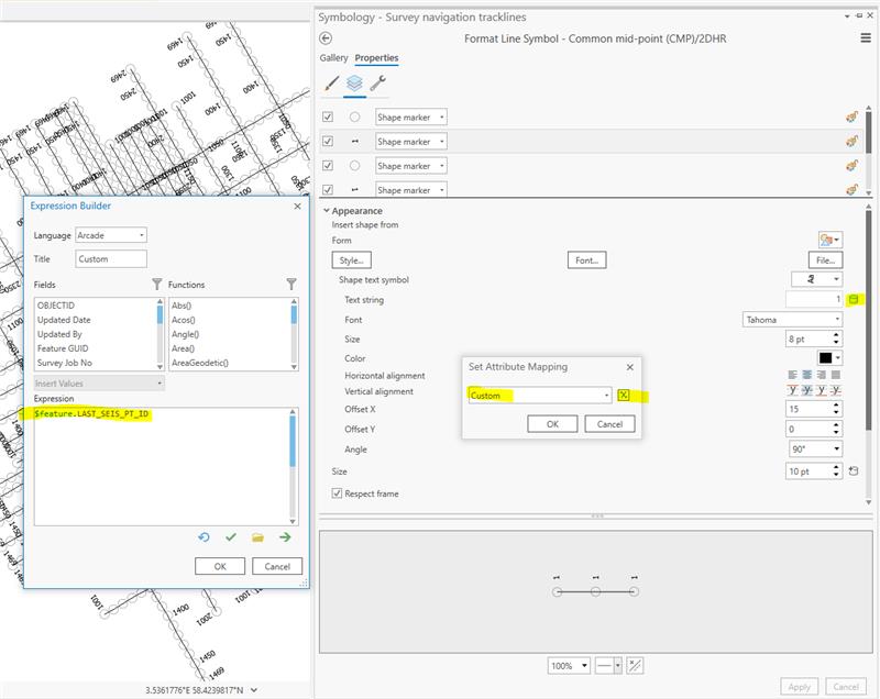

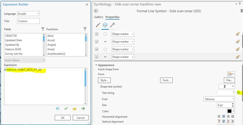

Here is how it is set up in the Map

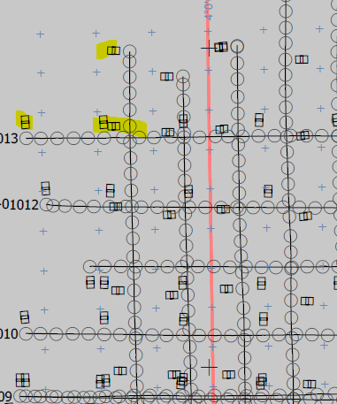

Here is how does the hatching looks like and how it is set up in Map (looks correct)

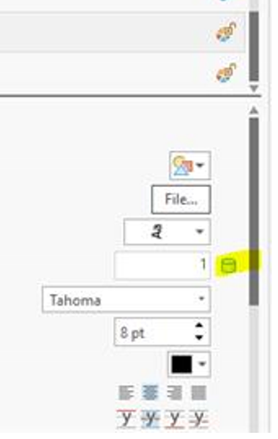

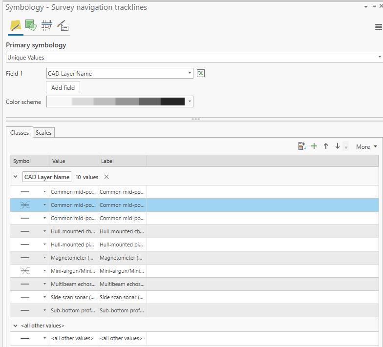

After using the same layer/copying it from other Map (with hatching already set up) into Layout (.pagx) the hatching functionality is missing. In this case we need to set it up from scratch
Here we can notice that the small database symbol is missing on the left hand side so editing hatching is not possible at this moment

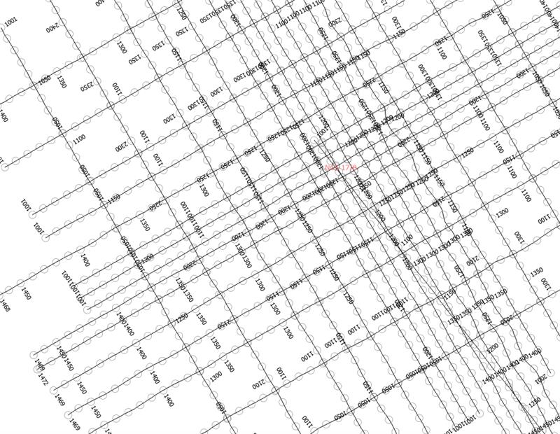

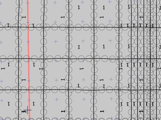

The second issue is the Export of Layout to PDF. After exporting to PDF, instead of numbers on the hatching we are getting some symbols while in Layout file it is  still looking fine.
