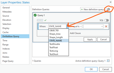

Definition Queries, Field Settings:
Issue: Clicking Sort Ascending or Sort Descending FAILS to display the names in the drop-down menu in alphabetical (ascending\descending) order.
Field settings (set to Sort ascending):
Field settings set to Sort ascendingField settings set to Sort ascending
Query List (fails to alphabetize)
Query listQuery list

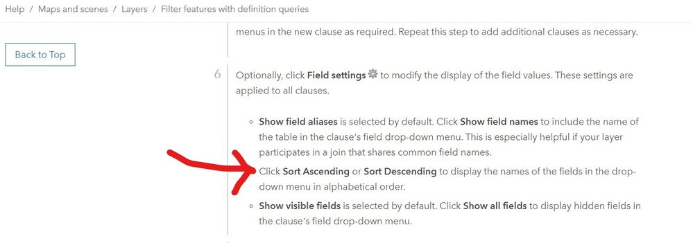

This functionality should exist per:
https://pro.arcgis.com/en/pro-app/latest/help/mapping/layer-properties/definition-query.htm
https://pro.arcgis.com/en/pro-app/latest/help/mapping/layer-properties/definition-query.htmhttps://pro.arcgis.com/en/pro-app/latest/help/mapping/layer-properties/definition-query.htm

The settings from the gear icon are for the query builder
I think that what you're asking for in terms of re-ordering the definition queries that show up in the Data tab > Definition Query group drop-down is submitted as this idea: https://community.esri.com/t5/arcgis-pro-ideas/adjusting-the-order-of-definition-queries/idi-p/92798...  I would encourage you and others you work with who would like to see this functionality to give that idea kudos and, optionally, add any specific use case in the comments.

I'm using ArcGIS Pro 2.8.2 and if I'm reading the Help correctly, the sort ascending/descending is for the Field Names not the Field Values.  I was able to sort ascending/descending for my Field Names without any issue.  The Field Values automatically sorted A-Z for me.  Not sure exactly what's going on.  Are you able to share a portion of the data with me?

For sorting Field names in the Query Builder, the Field settings sort order does work. Thank you. I had misunderstood the intended purpose of the Field settings (gear icon).
I am actually looking for a way for the product to automatically sort the resultant query list that resides in the Definition Query group (of the Data toolbar). It is now my impression that such functionality is a new feature request. Correct?
