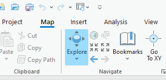

Updating this old thread for tracking and community documentation.
At ArcGIS Pro 2.4, the Navigation > Explore tool included this enhancement.  You can view m-values in a pop-up for a feature that contains measured values (m-values) in their geometries. The coordinate display at the bottom of the pop-up includes the m-value closest to the clicked location in the map or scene. For linear geometries, the value is calculated by interpolating between the nearest vertices.
Pop-ups for M-aware features
Related thread Link with Screenshots.

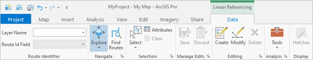

LRS community @PeteJordan ArcGIS Pro 2.9 has introduced a Linear Referencing tab on the ribbon that provides a new way to manage, visualize, and process measured data. Additional functionality to update route meaures has been introduced.
Linear ReferencingLinear Referencing(Note: this does not require advanced LRS licensing like Pipeline Referencing or Roads & Highways)
As posted previously, viewing measures was added to the Navigation > Explore tool at ArcGIS Pro 2.4. Further enhancement  includes additional measure fields in the pop-up display. Identify Route tool capabilities are documented as View Route measures.
Another neat addition is Find Routes that allows you to search by providing a Route Identifier and measure value without having to know the exact coordinates of the routes.

This thread is old, but with no updates for the LRS identification tool in 3.1.2 a workaround was found in our team... Our linework has DFO's and using the Explore tool:
and clicking on a linear item, the pop-up menu shows an M value - this is the DFO at that point:
Hope that helps - and thanks to our GIS team!
AyanPalit
Thanks @ESHERRI - glad your team is using this enhancement to the Explore tool introduced at ArcGIS Pro 2.4 - see my post. Feel free to mark as solution, so other users can easily find the post
