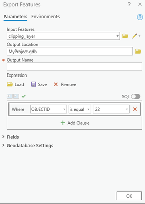

Thanks, I have been using the object ID to specify which polygon I want to export using the Boolean options...
Cheers
Ozplanman
I had a similar issue exporting more than the selection, not sure why given the above comments.  My solution was to use the "Expression" option, using the objectID of the selected polygon and this works fine.
