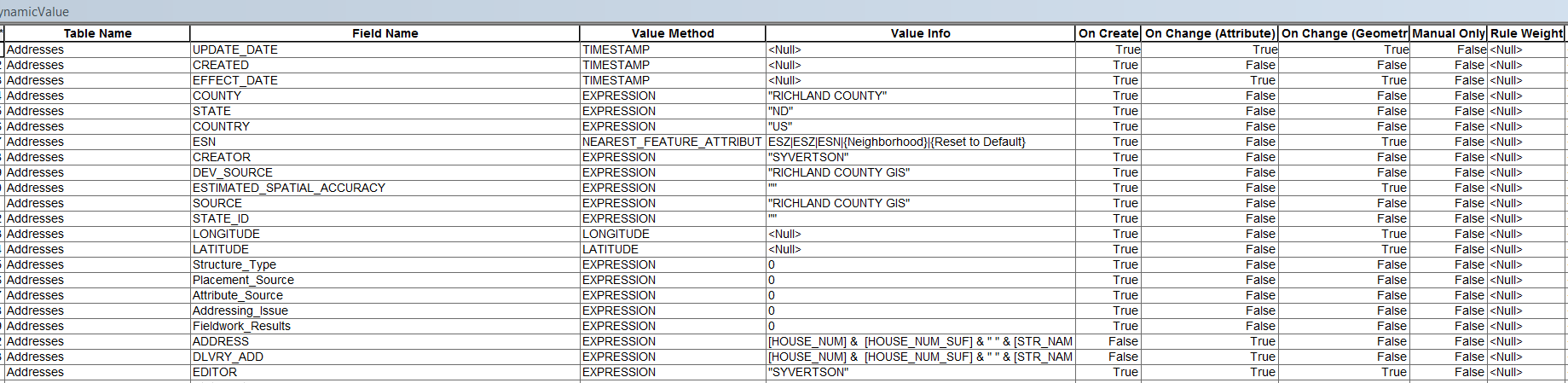

OK.  I have many attributes that I want updated automatically  (Some based on physical location, some based on who is updating the record and some based on other fields)  Some of the changes are made when updating the position of the feature, some when editing attributes, and some when creating a new feature.  See table below:
Can this functionality be duplicated using the transfer attribute tool?
