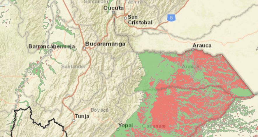

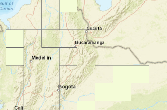

I have problems acceding to a WFS Service from ArcGIS Pro 2.0 + patch.  The service not showing correctly.
WFS:https://geonode.umaic.org/geoserver/ows
Layer: amenaza_inundaciones
OS: Windows 10 Pro
Any help to correct this inconvinient?
In anothe Machine with OS: Windows 8.1 this Service does not present any problem.
Result Failed
Result spected
