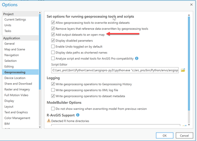

By refresh catalog... do you mean that the results aren't being added to the map?
If so... check your settings in the Project, backstage under Options, Geoprocessing

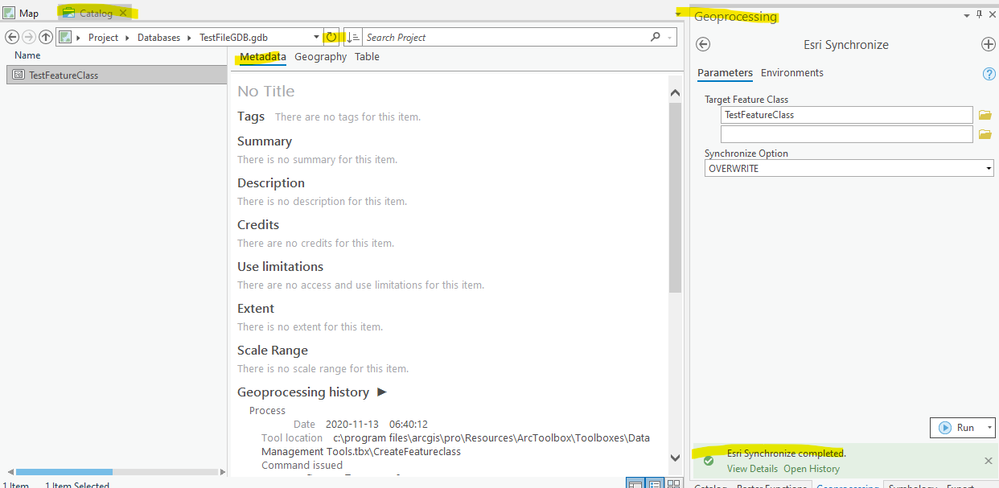

BobBarker
I'm looking for something (python or c# method) to cause the Catalog View to refresh when a Geoprocessing Tool completes.  For example, after running a simple python tool to perform a synchronize, the Geoprocessing Pane shows success.  However, the Catalog View does not show the updated metadata resulting from the synchronization. The user would have to manually click the refresh button to view updates.

BobBarker
yeah, we looked at arcpy and c# options but didn't see anything obvious.
