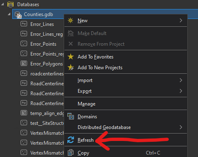

David_Lindsey
@HannesZiegler- What I believe this original posting is asking for is an ArcPy equivalent to right-clicking a folder or file geodatabase within the Catalog pane and clicking Refresh. In many scenarios, I am not needing to load feature class output as layers into the map, so that RefreshLayer() tool would not apply to those scenarios.
Example. If A) I'm actively connected to my Pro project's default file geodatabase (ex: Counties.gdb) through the Catalog pane, and if B) I use a geoprocessing tool within my custom Python toolbox that saves the feature class output to my Pro project's default geodatabase, then C) new output will not appear in that file geodatabase until I manually right-click it and Refresh within the Catalog pane. Does that clear things up? It seems like such a trivial piece of ArcPy functionality, and existed in ArcMap as RefreshCatalog(). We'd assume there'd be a RefreshCatalogPane() or something like that.
Clubdebambos
Hi @HannesZiegler,
Pretty much as @David_Lindsey stated above. A manual refresh is required to see the newly created feature class.
With ArcGIS Pro, when I have used ArcPy to alter a feature class, say the schema, a manual refresh doesnt reflect the change, I have to close down and reopen Pro to see the change take affect, this was never the case with ArcMap and using the RefreshCatalog() function.
To answer your question, this specific request is specifically related to the Catalog Pane and removing the need to refresh manually by implementing the RefreshCatalog() function that was available with ArcMap.

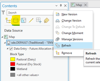

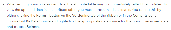

Michele_Hosking
I must be doing something wrong but as far as I can see arcpy.RefreshLayer() doesn't work. I deliberately upgraded to 3.3.0 to get this functionality.
I've included my script below in case there are any clues in it as to why it's not working.
This script is set up as a tool in a toolbox.  It has validation set up so a person choses the layer to run the script for from a drop-down list of available layers in the current map and then a list of available agreement numbers is populated to chose from.
I've put the refresh layer statement at the end of the script as it might loop through a number of times depending on how many agreement numbers is chosen to run it for. I thought one layer refresh would be fine at the end.
I've tried arcpy.RefreshLayer(futureLayer) which is looking at the layer as chosen by the user from the current map.
I've tried arcpy.RefreshLayer(futureDataEntry) which is the same layer but is the variable I actually use in the script (you can see how it's defined below).  Not sure if I still need to do this as I have pulled the script directly across from an ArcMap plugin but a million years ago when I created this I obviously thought I needed it....
Anyway - neither of these refresh the layer or attribute table in the current map.
See below the python code for images of the results (or non-results)
Not sure why this is so hard.
P.S. - this is a different application to that I described in a previous post on this topic but RefreshLayer doesn't work for me in that other application either.

This is the attribute table before the script has run and as it still appears after the script has run - and yes ok - but you have to have some fun when you're pulling your hair out!
I've also tried pushing the useless refresh buttons...
...on both the map and the attribute table - no idea why they are there.
The second image below is the attribute table after I have clicked the following
Just a thought - does this RefreshLayer not work when a layer is registered as versioned?  If not - why not?
HannesZiegler
Firstly, thank you for the write up, nothing inherently wrong stood out to me in your script. Secondly, with regard to your quote above - that is correct, have a look at Branch version scenarios—ArcGIS Pro | Documentation, it states the following:
Per our expert in this area:
Pro is a consistent state\moment client for multi-user enterprise geodatabase environments. What that means is they maintain a consistent view of the data until the refresh version moves that state\moment forward.
For layers registered as traditional versioned (stateID) or branch versioned (moment) this pattern should hold true.
For layers not registered as versioned the RefreshLayer workflow should show changes from other users made since the last call.
I would expect this pattern to hold true for branch versioned Feature services as well.
In short, refreshing multi-user enterprise geodatabase requires explicitly refreshing their data source due to the data model, this is as-designed. arcpy.RefreshLayer is not designed to work for these data sources.
