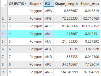

I was able to dissolve the data into their national level divisions.

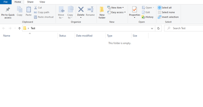

The task did complete successfully though the resulting folder was empty.
Was there an issue with the way that I choose to split the global raster? or is there perhaps another method that I should use?
