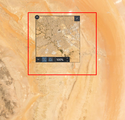

Bilal_Alam_GIS
You can use magnifier window which is seams same like new window in ArcMap. Right click inside map and click on magnifier. As shown in image below. Hope it will solve your issue if still you need anything else please let me know.
AvaFarouche
Thank you! But no, I'm afraid that doesn't help at all.  In Map, there was a whole separate viewer window that I could use to look at two separate layers side by side so I could create precise, accurate control points between those two layers.
The Magnifier doesn't accomplish that at all. It just magnifies one little square of the map, and that doesn't really help.  I still can only see one layer at a time accurately and the area isn't large enough to be useful.
