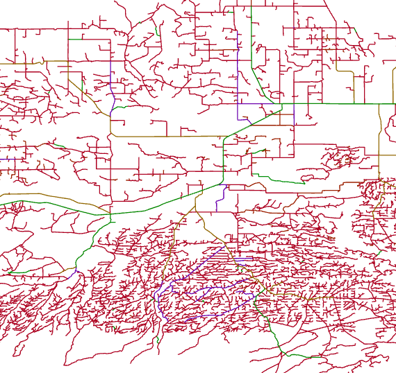

We have a set of shape files from a custom app that ran on Pocket PC. It contains a network of roads that we have been building and maintaining. The roads are mostly dirt roads. I have been able to import the shp files into a project as layers and then added them as feature classes. Here is a snip of what the roads look like.
The colors are the different shape files and each represents a speed limit which has been used when the previous app decides a route. What we want to do is specify a point using GPS coordinates and generate a route from the current location to the specified point following the roads on our map. We ONLY want to use the roads we define. Our trucks are restricted from certain roads. The navigation then tracks along that route, recalculating if needed. Turn by turn navigation and other bells and whistles are not needed. We just need to be guided along the path. Real simple requirements.
