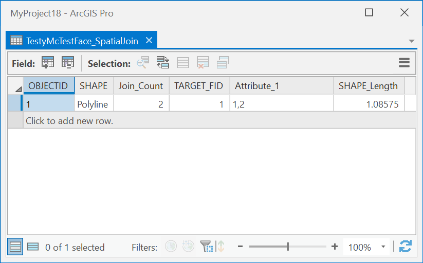

Hi Luis, this can be done relatively easily fortunately, although from my experience it's not common knowledge.
Just make sure that the field is a text field, as we will be using a join operation. Use field calculator to create a new field with a copy of it as a string if so.
One line intersecting 2 points:
S{
Spatial join of intersection, 'Join' field mapping specified with a comma ',' delimiter:
Output line:

LuisRibeiro
Hi David. Thank you very much! This is exactly what I wanted...
Some times answers are really more simple than you would imagine.
