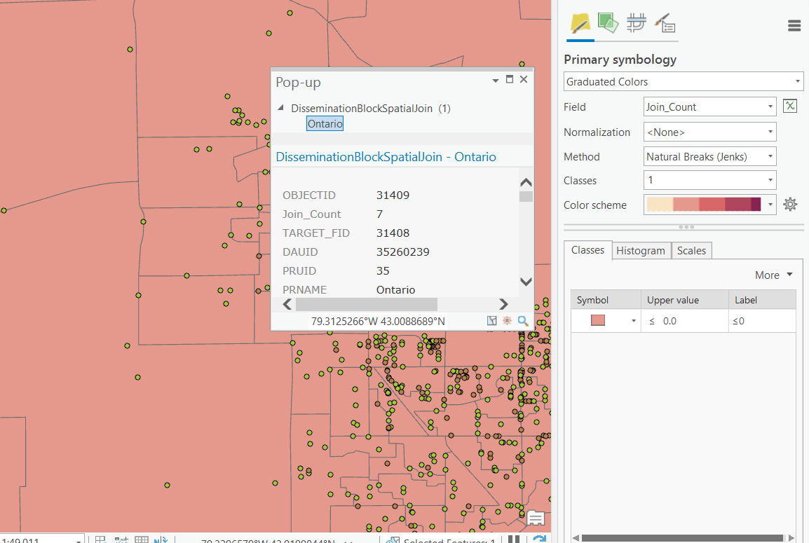

Please see below a spatial join on dissemination block using DAUID and First as the parameters. I've selected 1 block and I can see a Join_Count of 7:
Here is a screen shot for another, more heavily populated block with a Join_Count of 85:
So I am getting differing values, per block that look reasonable (need to figure out how to validate that), but I cannot seem to get the graduated colors to display it properly. When I try to a different value for Classes (e.g., 5) it snaps back to 1 class??

What does the histogram look like and also can you show the attribute table including all the columns.

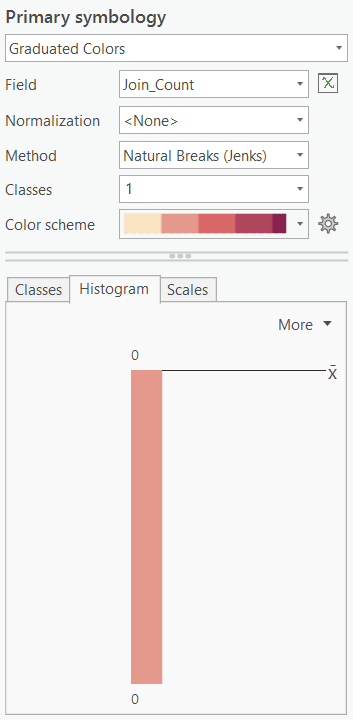

Looking at your screenshots, you are doing a graduated color with one class using natural breaks. What are you expecting from a single-class graduated ramp?
by Anonymous User
Not applicable
Hi Joshua,
When I tried to select more classes, it would snap back to 1 effectively removing the option
JoshuaBixby
MVP Esteemed Contributor
Ah, OK, now I understand.  With any histogram, the tool never defaults to sampling the entire set of values.  That said, the symbology tool should handle your type of situation better.
