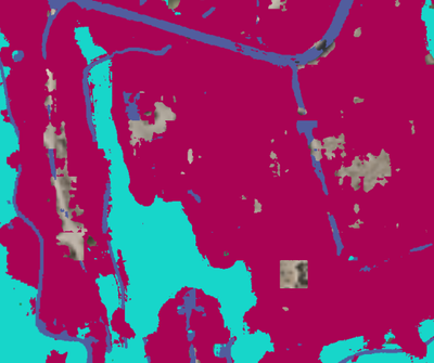

I recently ran AutoDL for all pixel classification models using training data I had created. It took almost four days. The results as they appeared in the leaderboard and the model metrics files were very promising, with accuracy in the 92-98% range for the top-performing models across my four land cover categories. However, when I use any of the output models to classify new imagery (same source and resolution, different nearby location, different date by a few months), my output is much less accurate and contains many "holes," or sporadic, irregular areas of no data in the output raster. Every model I try has these holes, but they occur in different places. One difference I should mention is that I ran the AutoDL tool using a single raster while I'm now trying to classify pixels in a mosaic dataset. Here's an area of no data:
I have tried several of the top performing models from my AutoDL result, I've tried retraining the output models with additional training data, and I've tried training a new model from scratch based on the AutoDL recommendations. I've experimented with changing the padding parameter, using test time augmentation and predicting background values. No real improvement.
If anyone has any suggestions specifically about the no data areas, I'd love to hear them. I had trained other models on my own before running AutoDL and I never had this outcome. I did re-export my training data before running AutoDL, so maybe I did something wrong during that step... if I had unclassified areas on my training data chips, could that result in this outcome? I'm thinking maybe my extent parameter was wrong when I exported the training data, resulting in some chips containing unclassified areas.

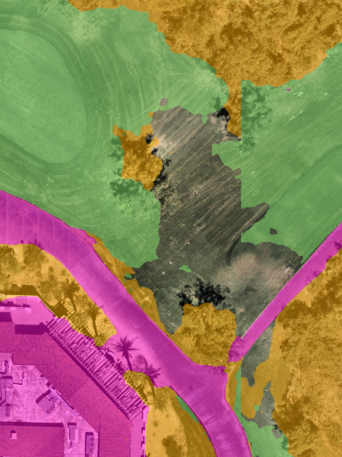

Yes, I used the Train Deep Learning Model tool try to train the best performing model (SemFPN), but now that I look at my GP history, I didn't actually train it from scratch. I retrained the SemFPN model that was output by AutoDL. That resulting model also produced an output with lots of holes:

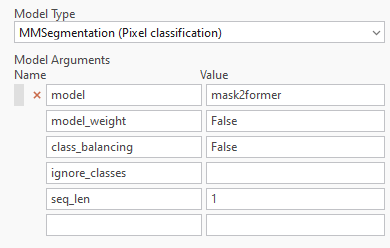

I now recall that I wanted to train SemFPN from scratch, but I'm not sure how to access that model architecture without retraining an existing SemFPN model. If I choose MMSegmentation from the Model Type dropdown, the "model" parameter has mask2former populated. If I change it to SemFPN or Sem_FPN, it doesn't accept it. I'm trying it as shown below (defaults) with new training data, but I have no idea what I'll get:
UPDATE: Just finally realized that if you hover over the red X, there's an error message that lists the possible model names:
"Error Invalid parameter. For MMSegmentation, model could be one of the supported model names:{'apcnet', 'mask2former', 'dmnet', 'prithvi100m', 'mobilenet_v2', 'fastscnn', 'ccnet', 'deeplabv3plus', 'hrnet', 'upernet', 'unet', 'nonlocal_net', 'ocrnet', 'deeplabv3', 'ann', 'pspnet', 'cgnet', 'fcn', 'psanet', 'emanet', 'gcnet', 'sem_fpn', 'dnlnet', 'resnest'} or could be path to the configuration file from MMSegmentation repositoryhttps://github.com/open-mmlab/mmsegmentation/tree/master/configs .For example, model:mask2former, model: C:\deeplabv3plus_r101-d16-mg124_512x1024_40k_cityscapes.py .Remember to use double backslashes \ instead of single \ in the path."
So all I needed to do was make it lowercase. Trying that now!

Regarding the second part of your question, the model names in MMSegmentation are indeed case-sensitive in the Train Deep Learning Model tool and must match exactly as listed. Using sem_fpn should resolve the red X issue you were seeing.
