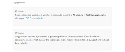

According to https://pro.arcgis.com/en/pro-app/latest/help/analysis/geoprocessing/basics/run-geoprocessing-tools.... one needs to have the AI tool suggestions turned on at install. Is there a way to turn these on after the fact you have already installed the software?

I think you can find what you want here: https://pro.arcgis.com/en/pro-app/latest/get-started/install-and-sign-in-to-arcgis-pro.htm#ESRI_SECT...
in the "Modify the setup" section without needing to uninstall and reinstall again.

I followed what is in the suggested link using the modify in the Microsoft Apps settings, but it failed as it was unable to reference an installer.
My steps that worked very well was to go to my profile in AGOL. Go to licenses and scroll down to Pro. I click on the link to download installer. Once downloaded running the installer will give you the same as what you are seeing in the link you provided. Also, for anyone that has their Pro customized, I did not experience any changes to my saved settings in Pro.
