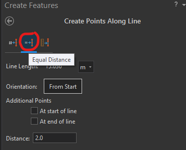

HI all,
Can anyone tell me how to add points along a polyline at specific intervals? I am looking at a powerline and need to create points at 500m spacing, so i can then add powerline junctions off these points.
I have tried the offset tool but nothing seems to happen.
DavidSolari
MVP Regular Contributor
If you're willing to dive into arcpy cursors and geometry objects you should be able to find a way to load in lines, generate points at set intervals along said line and then load those points into a feature class. There might be a stock geoprocessing or editing tool we're both missing but if you like solving little programming challenges this seems worth digging into.
DanLee
by Esri Regular Contributor

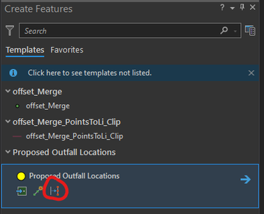

JohnWatt
+1 David and Dans suggestions.  There's both a GP and editing tool - the editing tool will let you create points along a line inside an edit session. Very similar but nice and interactive.
