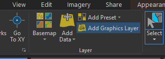

What version of Pro are you using? This is definitely possible.
Add a Graphics Layer, then use the built-in tools to add text wherever you like.

I have 2.8 but started on 2.4, so I wasn't aware this had been added (in 2.6 apparently).  Thanks!
