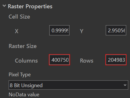

Sometimes when working with high resolution raster datasets we come across the error of row and column limit reached. Like for example in my organization's case it's set to 8000 rows and 8000 columns.
Is there a way to increase this limit? That way the raster can be used in its original resolution.
Error 001491 Cannot process above the size limits of the image service: '3DEPElevation'. The allowed maximum number of rows and columns is 8000 and 8000 respectively. Please adjust the output extent and/or cellsize to fit within the limits.

The solution that worked for me without having to clip/lowering the raster resolution/choosing a smaller extent was to use the raster from a network or local drive location. The rows and columns limitation goes away and you can use the raster in its original form (extent and resolution).
