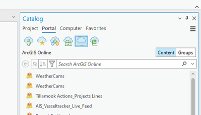

ODWC_GIS_0-1723758187611.png From the Catalog window, choose Portal, then look at each of the different icons representing an available source location.  For me, that is my items, my favorites, my groups, my organization, ArcGIS Online, and the Living Atlas.  You ought to see a Save Web Map button that'll do that.
